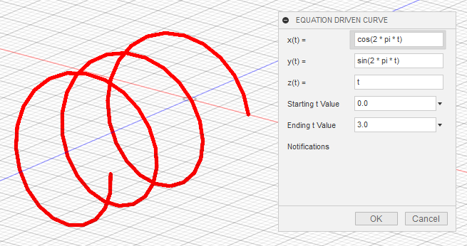

I built an addin to support equation-driven curves; it's just a toy right now, but I wanted to just throw it out here and see how close this is to what folks were looking for.  If you'd like to see additional features, just let me know and I'll see what I can do. I'll eventually get this up in the store once it's cleaned up and a bit more complete.
Here's the download: http://codereclaimers.com/Fusion360/EquationDrivenCurve-1.0.zip
Some example curves:
Archimedes' curveArchimedes' curveHelixHelixCycloidCycloid

Yeah, you can use parameters in the equations, but of course the Fusion360 API doesn't provide any direct mechanism (as far as I know) to go back and update created curves after a parameter change.
I can think of one hacky workaround I can try to let the addin do updates, but I don't know if it will cause Fusion to burst into flames or not.  Smiley Wink If I get a chance to try it out I'll post an update about it here.
@codereclaimers Oh...is there a special notation required to use parameters? when I enter one it says "unexpected token 'paramX' at position n." in the notification area. (Even a custom plugin would dictate that I'd have to manually regenerate a change.)
codereclaimers
Oops, sorry about that--I'm thinking about my other addin (the one for level surface meshes) that allows parameters in the equations.  I'm (still) waiting on the App Store to approve the equation curves app, and that version will allow you to use parameters in the math expressions.

The equation-driven curves app is now in the store (Windows-only for now): https://apps.autodesk.com/FUSION/en/Detail/Index?id=52036486659592142
If you encounter any bugs or think of some improvements you'd like, or just want to share something cool you did using the app, please email me at [email protected].

At the moment the addin uses the smallest number of control points required to make its internal spline representation match the ideal curve to within 20 microns, but I still need to do some experimentation to verify the created Fusion360 curve matches my internal spline representation.  Once I get that ironed out, I will expose the tolerance setting to the user.
