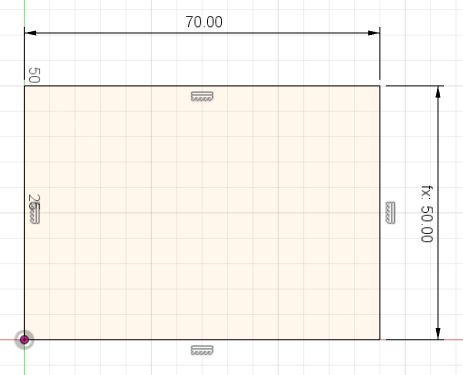

Hi, completely agree with this Idea, in Fusion 360 if I was to add expressions to a dimension, including naming it, there is no option to visually see this in the sketch:
