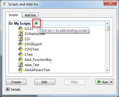

Here's a Python script that will do what you want.  I quickly created this so there are things that can still be improved that I hope to get to at some point but I wanted to make this current version available because it does work.
To use this, unbundle the zip file in any location and then use the "Scripts and Add-Ins" command to load it.  Use the green "+" as shown below to browse to the folder and select CenterOfRange.py.  You only need to do this once and then Fusion will remember the location after that.
To run the script, once it's been loaded, run the "Scripts and Add-Ins" command, select "CenterOfRange" from the list of scripts and click "Run".  It will prompt you to select a body, which can be a solid, surface, or mesh and then will ask if you want it to draw the range box.  It will create a new sketch that contains a point representing the center of the range box of the selected body and optionally will draw sketch lines to represent the range box. The result is not intelligent so if the body changes in some way, the sketch will not update.  However, if you run the script again and select the modified body, it will update the existing graphics rather than create a new sketch.  An example of the result is shown below.

 Great script @ekinsb ! I noticed this works with files created within Fusion, but not with imported .step files for example. It error'd out at line 73 - RuntimeError: 2 : InternalValidation Error : fragment.
Any way to accomplish bounding box for imported .step files? Thanks!
ekinsb
The problem was that the program didn't support designs that were set to not capture design history (Direct Modeling), which is the default when you import a STEP file.  I've updated the program so it now supports for parametric and direct modeling designs.  My first post above has the link along with directions on how to install and enable the script.
