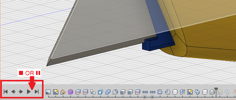

Occasionally, I will accidentally click the "play" button on the history bar, the one in the lower left corner.
As soon as I click this button, Fusion 360 immediately scrolls through all of my design from start to finish. There is no way to pause or stop this progression, and for some of my larger design files, I have to spend 15 minutes waiting for the progression to end before I can actually do my work. Please incorporate a pause or stop button into this feature. Not only will it allow those who accidentally click it to remove themselves from the situation, but it will also allow people who want to inspect a specific moment in the design to pause the progression at a certain point.

To be honest, considering that there is absolute no way for us to stop Fusion from playing the entire design history, I consider this a *requirement*, not an idea/suggestion.
This weekend, I had to wait for about an hour or more for Fusion to finish replaying after I accidentally hit the Play button.

I agree with all the above ( @Anonymous and @fulcrumusa) , it takes a very long time!
Please add "stop" or "pause" button.
If I want to record a screencast about model with large number of elements and view perspective changed, I can not stop the process. I have to do some part screencast again. A similar problem when I check any step of creation and need to stop the moment, but I can't.

I agree and The "forward" and "play all" looks too similar and if you pressed the wrong one in a large assembly... 😮
Making them look different would help greatly.

PLEASE!!!  I have been working on a model and stepping back and forth through a LONG timeline and click, click, mouse drifts off to the side and then PLAY - now I am stuck waiting over a minute for the play to run through.  A stop button or a preference to disable (hide) the play button would be huge.

Hey all, no, we have not forgotten about this idea. There are significant technical hurdles we need to get over before we implement any kind of solutions here. One of the things we're reviewing right now is the ability to end a timeline compute in the middle of a playback. A couple of other options we're looking at are:
1. moving the play button to the center so that it is standard with all playback UI.
2. provide an option to remove the play button.
More to come.

I agree it should be fixed ASAP and in my opinion it is more of a UI issue than a feature issue. That can fixed as easily as changing one of the 2 play button's colour (image sprite) to differentiate them apart.

We are currently working on this. We are hoping that it will be done for the April update.
I just been waiting almost 20 mins on a model for the playback :)) it's frikin you out, hope you guys get on this soon ^^
keqingsong
Good news - this is coming in the April 12 update!
