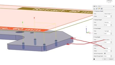

Fusion 360 Manufacture V2.0.12160 Drilling problems :
"Top Height - hole top" is reversed with "Bottom Height - Hole bottom".Captură de ecran 2022-01-27 092250.jpgcap3.jpg

ECPIRO
I have been using Fusion 360 since 2019. This is a new bug starting with the January 2022 update.

yirang.choe
Hi @ECPIRO, I'm not sure if I understood your issue correctly. Could you elaborate more on it? If it's a bug, I'll share this with the Manufacturing team.

ECPIRO
This only happens for: "Selection Mode - diameter range".
If "Selection Mode - Selected face" there is no such problem.
