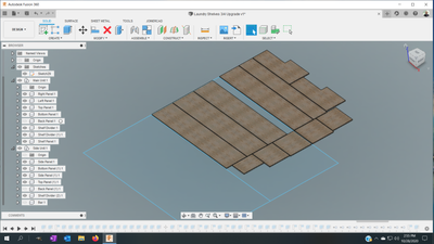

Thanks for adding arrange, it is a great feature, I'm using it to layout cabinet panels for plywood cutting to determine the number of sheets needed for the job.  Only thing that doesn't work quite right for me and it could be something I'm doing is that after the panels are arranged, they don't necessarily move to the sketch, I believe they are off plane and don't know what I did to get them that way, I drew the scetch on the same plane that I modeled the cabinets.
Additionally, when the feature is finalized it would be nice for wood workers to be able to sketch one 4X8 sheet for example and if the parts won't fit have the program add another identical sketch until it has placed all the parts.  Now I have to guess about how many I'll need, which on small projects is ok, but for big programs, not so much.
Here is a screen shot of a cabinet set (2 cabinets) that I arranged.
