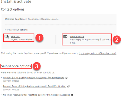

    1. Open a support case or chat with an agent
      1. On the top-tight corner of the screen click Sign in and then enter your Autodesk ID.
      2. In the middle of the screen click Education and trial support.
      3. For the topic, select Software for students, teachers and schools.
      4. Select the desired topic.
      5. Depending upon the selected topic, you can add a description for your issue and then click See options.
      6. On the next screen you can click on the option to:
        1. Live chat.
        2. Create a case.
        3. Self-service options.
