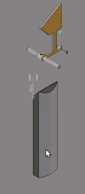

I will begin by saying I have been using this software for about two weeks, which is the sum total of me design experience. I am attaching part of the assembly as it is much larger, but the rest is irrelevant with respect to what I am trying to accomplish. An Spire is sliding up, and will contact a pin, which rotates about a shaft. I am trying to create this to see if the design is even probably, as I feel it is not, but would rather prove it.  I thank you kindly for any and all help

You are missing a few standard ideas to animate this.  One, you do not have a grounded component, I grounded the flag pivot pin.  Two, you did not have the slider motion independent to the flag, I added a sketch line to use as a Slider join reference.  Even with all of this, I can only "manually" slide the spire and make the flag respond.  The reason the flag stops at 45 degrees is because the counterweight is resting on top of the spire in a equilibrium position.  Model is attached.

You are indeed correct. I knew this lever wouldnt work, but I like to prove things, and my reach exceeded my grasp for certain. I thank you for both the reply and the solution.
