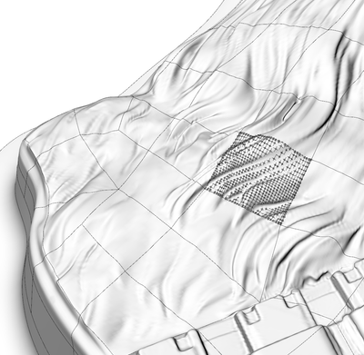

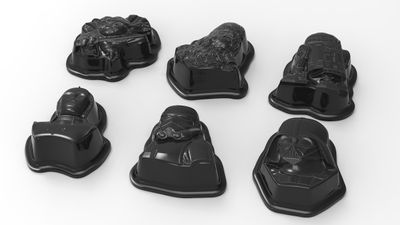

mcramblet
This image shows an example of a comfortable amount of surface detail that I've been able to achieve with T-Splines and traditional CAD:
Not bad for a 100% CAD workflow. But for something like this:
For this level of detail, a non-traditional approach is needed. These were created in Geomagic Freeform, then surfaced to bring into CAD, and completed there. The small surface patches and the corresponding point structure of the patches can be seen here:
Crazy surface detail like this is best done outside of CAD, then brought in to complete manufacturing.
Message 14 of 20
