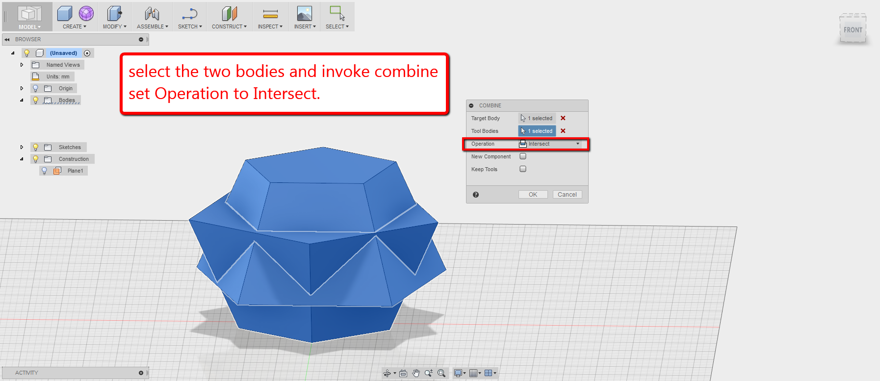

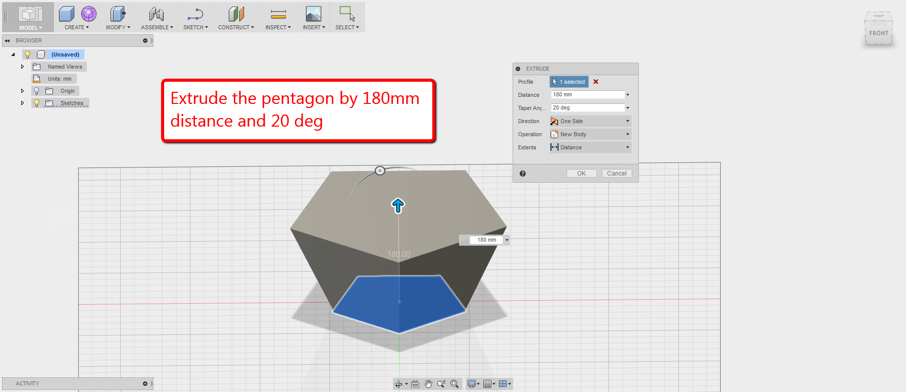

In this case you could try what Claas said, those methods are all available.
I am going to demonstrate you how i do it briefly.
Hope those could help.
Of course you could adjust the shape by different values at each step if you are not satisfied with what i have done.
Regards.
