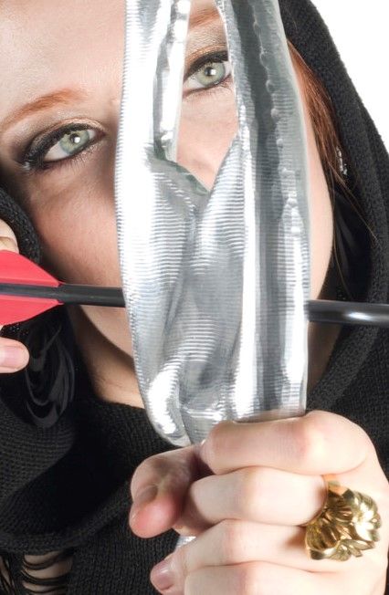

The automatic BRep conversion of FEA mesh is an arena where a lot of CAD and CAE firms are preparing to square off. This new wave of generative tools has us all realizing just how awful mesh data really is. Lots of companies are trying their hand at this in various ways. The hardest part is reconciling known details with the mesh. For example, if I have an optimized part that had round features for bolt interfaces, the true roundness is gone. The mesh has approximated the curve and left me with a faceted model - one that ends up leaving super nasty surface artifacts. Take a look at this cropped image of a Generatively Designed bow (from an Autodesk Artist in Residence at Pier 9). You can see just how janky that faceted surface is on the machined part. The finishing strategy was an attempt to hide the facets, but they are still very visible.
