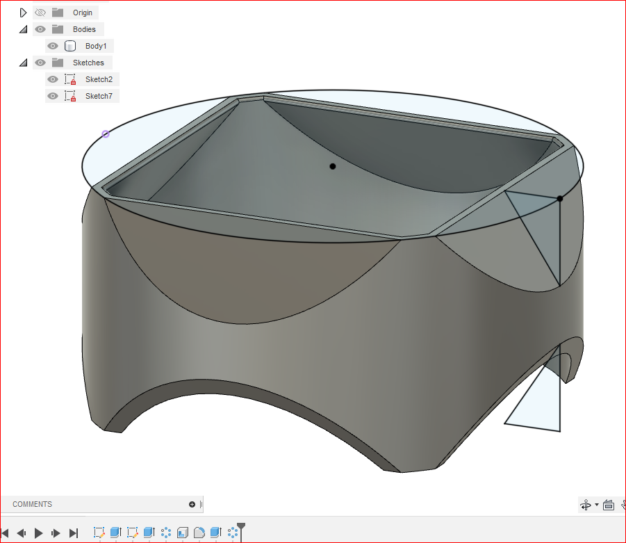

Long time listening; first time caller here.
I'm trying to build a camera lens hood (file attached) and I've got the general shape by doing the following:
- extruding a cylinder of the total overall length.
-working on 'adjacent' faces, sketching, then mirroring along the axis of the cylinder, a triangle, which I then extruded to create the end detail.
-used the shell tool, choosing the ends of the cylinder, to create the final shape.
The issue I see is that the shell tool allows you to specify material thickness, but I'm a bit stuck as to how I get the internal diameter I need in order to fit over the lens.  I see a kludgy workaround if I make the initial OD of the cylinder equal to the final ID + the shell thickness, but this seems intuitively wrong to me (and when I tried it, it didn't really work out).
Any feedback or vague hints would be appreciated.

TrippyLighting
The ID is OD - 2 * Wall thickness ?
I am not sure where you see the problem.
davebYYPCU
Measure the original object,
working from that diameter, plus clearance, = ID,
Od will be ID + wall thickness times 2 as Trippy says.
Wonky is these bits, needed or not they are not the same.  I am guessing they are not required, and you fix that with better sketch alignment.  When you get more experience, you would make 1/4 of the model and pattern the others for efficiency.
Blue lines (undefined) in your sketches have caused these sliver faces.
Might help....
