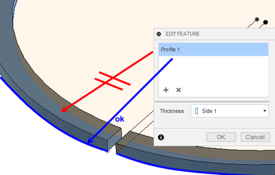

g-andresen
you´ve to choose the right profile!
screencast
günther

Ohhhh. I think I know what I was doing wrong. When I want to decide the thickness of the ring, I have to use the sheet metal rules to do that, I can't just have two circles the width away. I have to select an edge not a face when I create a flange. If I'm wrong, thank you for bearing with me, and please tell me how I'm wrong. If I'm right, please tell me how to modify the sheet metal rules. I just want to make sure that I know how to set the thickness of the flange. Thank you all, you've been super helpful so far.
