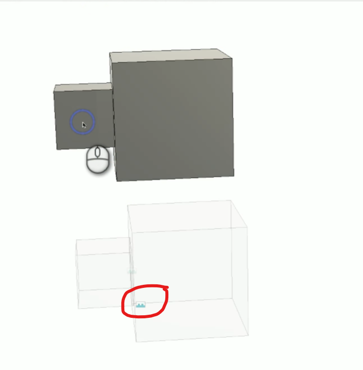

It appears as if the as-built joint is attaching to the other two components. When you select the second component for the as-built operation the rigid icon appears on the other two components. (The action is at the 3:01 mark)
That's looks to be a bug.
Can you confirm the components through the browser tree?
Message 14 of 22
davebYYPCU
What is not shown in the video, is the Origins for Document and each component.(totalling 5)
until the change of body size with the normal Joint, all Origins are overlaid.
After the changed parameter, for the normal Jointed box, that component origin has adjusted position.
So yes - in effect the other 3 components own the same component origin position as the document. The position of the joint icon in the window is insignificant for this discussion.
