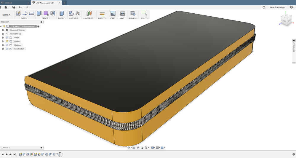

melvinbrian3d
nice... in addition to you... i think u can create a middle construction plate and project the top path, and then Pattern along the project path
MelvinBrian3D
melvinbrian3d
something like this...
MelvinBrian3D
melvinbrian3d
I hope you like it
MelvinBrian3D
melvinbrian3d
I create a sketch and draw the two teeth
then I extrude them individually and apply a chamfer
then I Pattern the features along the Path
I hope you like it
I will leave below the .Fd3 File
MelvinBrian3D
