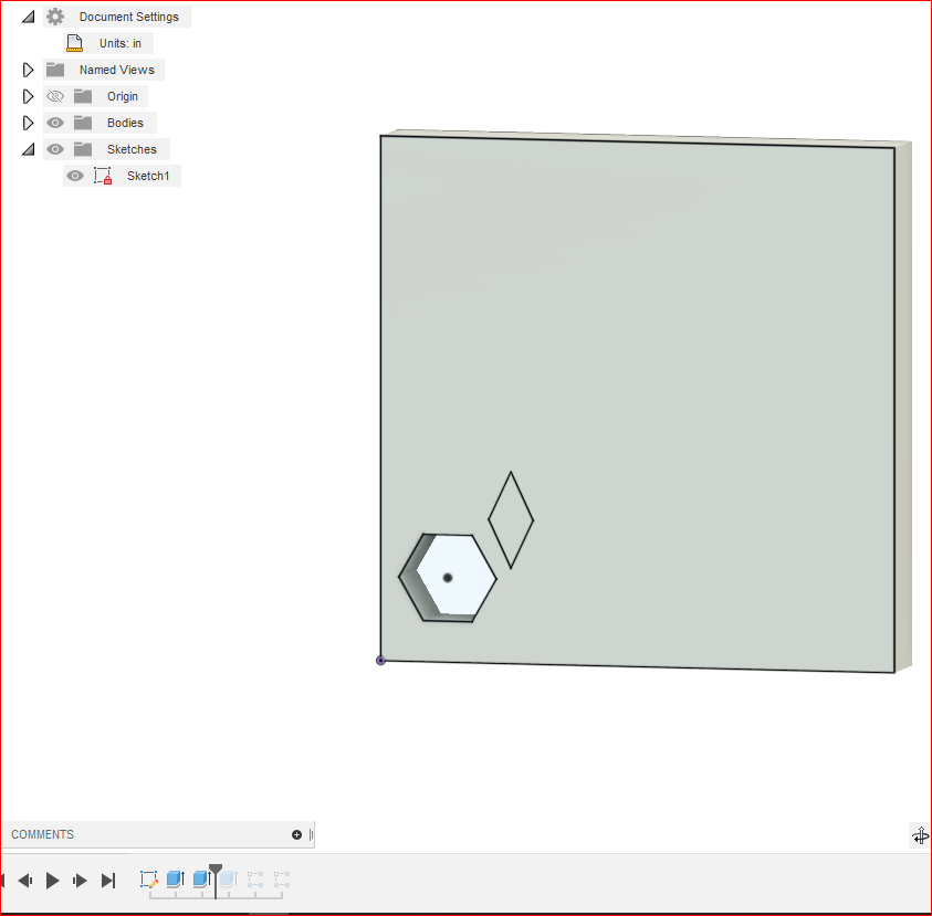

I'm having trouble using the measure tool to find the correct distance for a rectangular pattern. I am trying to evenly space weight saving holes while using an attractive design consisting of a rectangular pattern of some polygons. I started by sketching some polygons and fully constraining them, but when I try to measure distance for a rectangular pattern it just... doesn't work or I don't understand how it's supposed to work.
I also tried creating the pattern and THEN apply some sketch constraints, e.g. a line from the lowest shape in the pattern to the bottom, and a line from the highest shape in the pattern to the top, and then applying an equal constraint to get the right distance. But Fusion 360 is either unable to compute the result or I over constrain the sketch.
I'd like to correctly space these rhombuses between these hexagons.

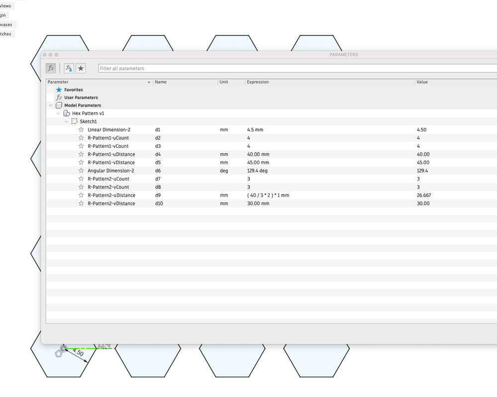

Warmingup1953
the key is capturing your fx of the rectangular patterns and the quadrilaterals pattern distance fx/3*2 (of the hex pattern)Screen Shot 2023-02-25 at 5.27.40 pm.png
excuse my unconstrained quad
Message 3 of 13
Warmingup1953

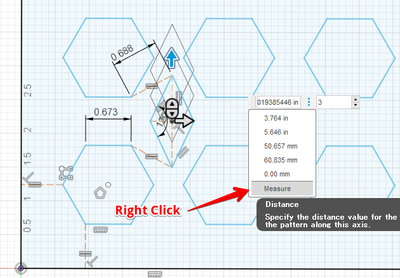

Bunga777
How to use measures in patterns
Right-click on the measure.
Once in measure mode, the cursor will take the shape of a ruler.
If it doesn't work once, try several times.
Once the cursor takes the shape of a measure, click on two places where you want to measure, and the value will be automatically entered.
To exit from measure mode, press the ESC key.
Please watch the video of the operation and refer to it. 
(view in My Videos)

tbrandtsiue
This is also a great solution that makes a lot of sense. So the function here is essentially (outer pattern distance / outer pattern quantity) * inner pattern quantity.
So the distance between each item is the same in both patterns
