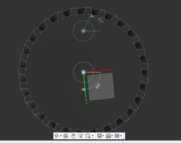

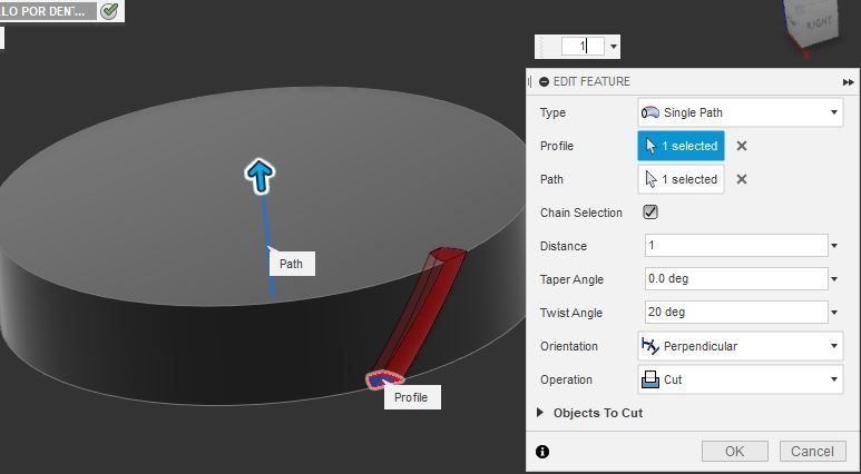

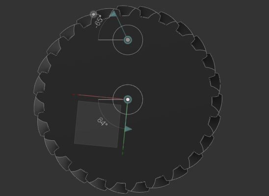

Like you can see  i design a ring and planet gear. But when i use sweep and twist angle to create the helical type of gear. The inclination does not match even though it has the same angle And i need that to make it works.
I use the same angle in the ring and in the planet 20  degrees but its to different, i try to change that divide but it's still not exact. Somebody can explain me what happen?

The problem is that using the twist angle is the wrong tool for the job. That is rotating your profile 20 degrees in rotation so depending on the diameter of the gear, the helix angle will change. The larger the diameter the greater the helix angle for the same amount of rotation. You will need to project a 20 degree line to the face of the gear and sweep the profile along the line.

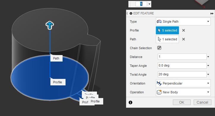

chrisvargsch
I just tried again and its work, you can see. I had to use extrude too like you see

I think the original idea of using a sweep with twist for the smaller gear was on the right track.  when cutting the teeth on the planetary gear you would need to sweep using an edge created from the first gear as a guide path.

The sweep feature can still be used in this situation, but the twist angle must be calculated from the specified helical angle (α), pitch circle diameter (D), and gear height (H). This is because the definitions of helical angle and twist angle (θ) differ.
Formula:
θ=2⋅arcsin⁡(H⋅tan⁡(θ)/D)
This relationship is derived from the geometric construction shown in the diagram below.
For example:
  • With α = 20°, H = 6 mm, and D = 8 mm (planet gear), the twist angle θ is 31.7°.
  • For the ring gear, using the same height (H = 6 mm) but a larger pitch circle diameter (D = 24 mm, to accommodate four planet gears and one sun gear), the twist angle θ is 10.4°.
Of course, all gears must share the same module to mesh properly.
