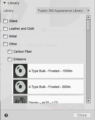

The new batch of emmisive materials is now released in fusion. They appear in material library like so:
There's a pretty good range of templates for making self-illuminant. Many of these include examples textures intended to be replaced by your custom textures.
For example, I started with the OLED preset to make my iWatch display more plausible.
OLED display
I also used a very bright .5mm x .5mm rectangle with the green LED preset applied. I increased the luminance to 10k nits. Note that these simulated LEDs are behind a diffusive windows.
Bright green LEDs
In case you didn't know, you can now render turntable animations of your fusion models from A360. I uploaded an example turntable over on the rendering gallery: https://rendering-gallery.360.autodesk.com/projects/apple-watch-38mm-case
