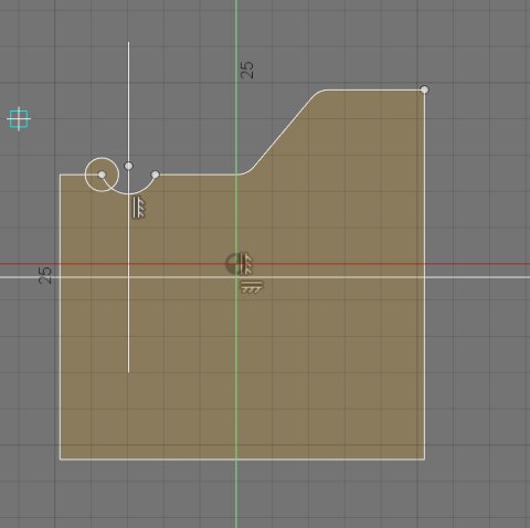

Here are some pictures to show how I find gaps in profiles. You can find the gap quite quickly by drawing a few lines.
Open profile.
Horizontal line shows gap is in top half.
Vertical line shows gap is in left corner of profile.
Circle around corner with gap. Now you know where the gap is delete the circle and try extend on the arc and line.
A quicker way to find the opening with a zig zag line.

Here's a screencast that shows an imported design made from splines, there's a break in one of the splines but Check Sketch doesn't find the problem. Using the method from the first post you can track the problem down.

Brillant - yet so obvious(now we know). Thanks

Thank you, I am new to Fusion 360 and CAD programs in general.  I was watching some youtube videos on how to do a project when I ran into an issue.  I was about to give up when I found this thread and easily fixed the problem

Brilliant--saved me HOURS on an imported SVG.
