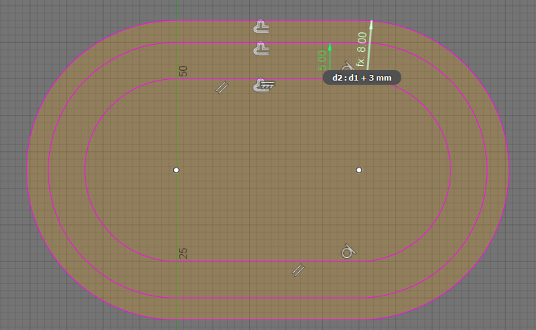

I've noticed this in a couple drawings, not sure if it started with the latest update.
I'm unable to create an "offset" from a curve that itself was created as an offset.
Video below. Sure, I can offset from the original one, but I'd like to keep things relative the width of the feature.

Select the "offset' constraint and delete it. Now you can do the offset.

   I just discovered that when using the 'offset', if you type in an amount for an offset, that value stays with the dialogue box the next time you use it.
So instead of deleting the constraint and offseting the line you could simply offset the original line again and again by typing '+4', for example or whatever amount you want. That resulting value will show in the dialogue the next time you use offset.
 Using the 'offset' arrow is different. It doesn't affect the value that appears in the dialogue the next time you use it. The dialogue keeps the last number typed into it.
Doing the offsets this way allows you to edit the original curve and have the offsets update. Can't do that if you delete the constraints.

Here's another option offset from the original curve and use the parameter from the first offset + the offset you want from the first offset curve. So the first offset is d1, to offset 3mm from that curve add d1 to the 3mm. Both offset remain parametric done this way.

Just to add to my previous post to get the parameter just hover the mouse pointer over the dimension for a second and it's displayed.

Tried this yesterday and it works OK, only, you cannot select a dimension, you can only type the dimension name, so you need to know the name. Not too big of a deal but not consistent with other commands where you can select a dimension as input.

Yes, this is a known limitation of offset, and a tradeoff we had to make along the way.  I won't go into the details, but it is complex once you start doing offsets-of-offsets-of-offsets...
We do hope to improve this over time, but it is unfortunately a large project.  So, we made a decision that there was enough value in a fully associative offset, even with this limitation, to justify releasing it.  In the meantime, as @HughesTooling suggests, just keep going back to the original.  The result is the same.
