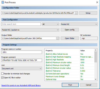

Sorry my PC was down... It sounds like the post you are using doesn't support 5 axis. I would select a different post.
You can select the Pocket NC post when you choose to output tool path.
I've also attached a 5 Axis example it's 3+2 type programming. But it will show you the basics of setup and output using the Pocket NC post.

@RandyKopf the PocketNC post does not work with my Mach machine, even if I change the extention to .txt. Thanks.

When I try to post this toolpath with the generic mach3mill post, it gives me an error and I'm unable to get any post of out of it.
When I try to post this toolpath with PocketNC, it works but my machine will not load the toolpath.
After lots of research and reading, I need to modify the mach post to work with my machine. I just don't know how to do that (yet).
