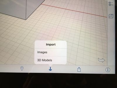

is there another way to import an image as i do not have the import button
josh.goldstein
Hi Bryn,
You should be able to import images from your device's photo library into FormIt using this menu:
