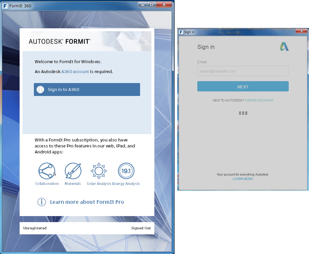

Thanks for the useful information. I have similar problem but I'm not sure that it applies to your post.
Attached login screen is not fully blank but can't type anything. Is this the same problem?
We use NVIDIA Quadro K1200 for graphic.
Thanks in advance!
Message 3 of 8
tvollaro
Does the progress indicator (three rectangles below the Next button) move/animate? If so, that probably indicates a connectivity issues. If that screen is completely frozen (no animation) then it may be graphics related.   If the former, see this page re. unblocking Autodesk services from firewalls, etc.

I just installed Formit for windows and opened the program.
The program asked to sign in in A360 but I cannot type in my account details, it doesn't allow it
I've read the suggestions in this post and tried several suggestions already mentioned, but it doesn't fix the problem

Can someone help with this strange problem?
When starting Formit an A360 account is acquired.
I can't type in my account details in the following screen. I have an A360 account and is accessable through the internet, but not within Formit.
Login A360Login A360
Thanks in advance

I am sorry you are having trouble logging into FormIt. Can you click anywhere on the login screen? Can you click on the "Learn More" link at bottom of the page? What if you move focus away from FormIt and then bring it back - using Alt-Tab?  Also, are you certain you have the most up-to-date drivers for your graphics card(s)? If you have switchable graphics on your system, you should make sure that the drivers for both cards are updated.
Tom Vollaro
Experience Design Architect - Autodesk
Message 8 of 8
Hi Tom,
Thanks for your response!
I had updated my second graphics card but not the standard laptop graphics card
Problem solved for signing in in A360!
