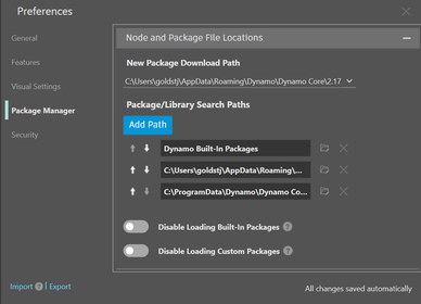

josh.goldstein
Thanks for trying it out, hopefully we can get this resolved! Sorry your first experience was a string of failures, but we do think this is an isolated case, not widespread.
The Dynamo team suggests the following based on recent issues reported around conflicting package paths:
  • Launch Dynamo
  • In the Dynamo menu, select Preferences, then Package Manager, then Node and Package File Locations
  • Do you see anything beyond these 3 items?
  • If so, screenshot it and share here, then delete the other package paths
  • Close Dynamo and FormIt, try again
It's possible there's a custom node interfering here, so if you wouldn't mind sharing your list in this dialog, we'd appreciate it.
Josh Goldstein
Senior Product Manager
Message 17 of 26
DEBLAG
Nothing in the paths other than the 3-items shown in your preferences.
Message 18 of 26
