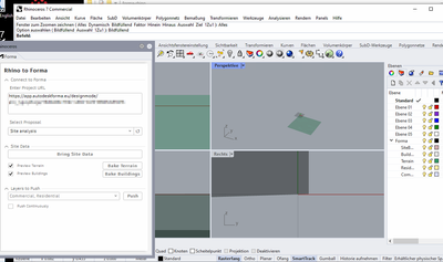

Hello, I've followed along with the "Rhino interoperability add-in" video on the following page: https://help.autodeskforma.com/en/articles/8255655-rhino-interoperability-add-in-in-beta
but the link toolbar in Rhino does not allow me to pull anything from Forma besides the site polyline.  Why might this be the case?

Hi, it looks like you're using version 0.6.0 0.5.9 of the Forma Rhino add-in. The options to preview terrain and buildings were added in 0.6.1 0.6.0. You can download the update from the Centercode beta site.
Also, depending on where your project is located, the data providers' license may have restrictions on exporting their data outside of Forma.

to come back to the initial question, why the geometry is not imported in Rhino: i use the 0.6.0 Plugin and can also only import the sitelimit and terrain in Rhino 7 but not the geometry. I tested different projects and sitelimits but the geometry is not imported. In the forma video mentioned above it is shown that it should work. This should be clarified.

We have released a new version of the plugin that should resolve the building issues.  Release Announcement.

Hi, I think the 0.6.2 release just posted might address the issue you are showing, as it has a general fix for problems receiving surrounding building context data. You can try the new version from the beta site:
https://feedback.autodesk.com/key/FormaAddinForRhino
