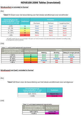

Wind hazard study is an addition to the wind comfort study.
As far as is known, the same data are used for this, but with a different calculation.
For example, it is also important for the wind hazard what percentage of the hours per year these wind speeds occur in order to determine whether this poses a hazard or whether this is acceptable. See below the translation of the tables from a NEN8100 wind analysis.
PS the NEN8100 uses the NPR6097 wind rose, not sure if this would give the same results using the fixed GlobalWindAtlas3.0 wind rose.
Would you like me to send an existing (Dutch) wind comfort & hazard study by PM?
