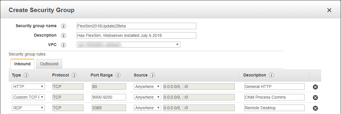

Step 1: Create a Security Group
You will need to create a security group with the following rules:
  • Allow HTTP traffic on port 80. This allows incoming connections to the FlexSim Webserver. You can choose which inbound IP addresses to accept. You should make this as strict as possible. The strictest setting is to only allow incoming connections from the current IP address.
  • Allow TCP traffic on ports 9000-9200. This is a Custom TCP rule. Note that you can make this range smaller, if all machines that use this Security Group have fewer than 200 cores. For example, if the biggest machine launched with this Security group has 72 cores, you would only need ports 9000-9072 in this rule.
  • Allow RDP traffic on the default RDP port. This allows you to connect to the instance using remote desktop.
Name the Security Group something that shows that this group is related to running FlexSim instances, and add a description if you want. Here is an example Security Group that works, but allows all TCP traffic, and so should only be used for testing purposes:
