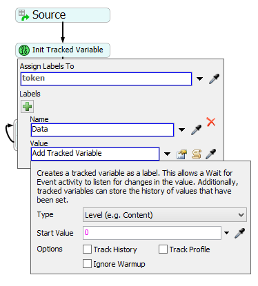

The Scheduled Source creates three tokens, each of which create a label called data. This label is created by choosing "Add Tracked Variable" for the value, which opens this dialog box:
The reason we want the label to be a Tracked Variable is that Tracked Variables emit an OnChange event. We want to listen to that event. If you use the time interval collection method, discussed later in this article, you don't need to make the label a Tracked Variable.

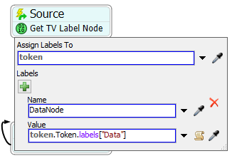

This flow has an Event-Triggered Source, which listens for tokens to leave the "Init Tracked Variable" activity in the first flow. When that happens, the source creates a token, and that token immediately gets a reference to the label node (note that this is different than the value of the label node).
