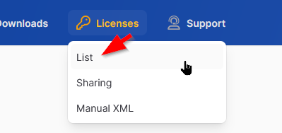

  1. Log in to your FlexSim Account, click the Licenses link in the top menu. In the Licenses submenu, choose List.1695388060566.png
  2. Expand the various product and version folders to find the Activation ID you wish to activate. An Activation ID looks similar to this example: yourcompany.com01-ABCDE-FGHIJ-KLMNO-FSENT16.2

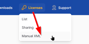

  3. Click the Licenses link in the header, then choose Manual XML in the Licenses submenu.1695388087498.png
  4. Upload your XML files by dragging them onto the drop zone.
  5. Your uploaded XML requests will be processed. Upon completion, you will be prompted to download each XML response.1638575665074.png
