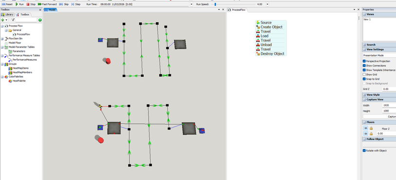

Hi Everyone,
I am trying to develop heatmap using process flow and direct using "A" connection, but there is some issues, some one please find the image below and suggest how to show the heatmap in both activities please.
