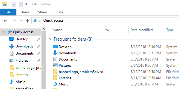

Sometimes when FlexSim has trouble starting up, it can be due to a corrupted prefs.t file. FlexSim's prefs.t file stores your FlexSim settings and preferences and is located at:
 %APPDATA%\Flexsim\FlexSim <version>
The %APPDATA% address is a shortcut to your Windows user account's Roaming directory. This animation shows how to get to your %APPDATA% directory:
With FlexSim closed, delete this prefs.t file. Then try starting FlexSim. Are the problems resolved?
