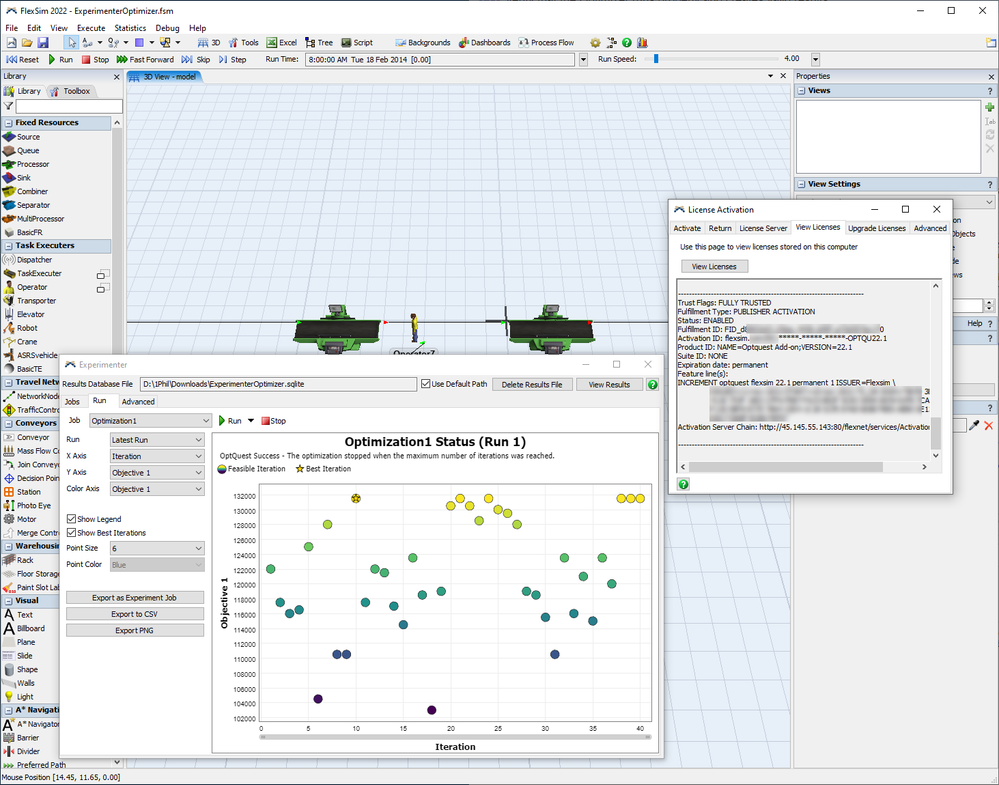

It seems a 22.1 OptQuest license is not recognized by the beta, while a 22.2 works just fine.
Is that a bug?
What does "is not recognized by the beta" mean?
Seems to be working fine to me:
Phil,
In the "Jobs" tab I can add an Experiment only, but not an Optimization. If I load an old OptQuest model, I can duplicate the Optimization, but still not add one. Menu just shows "Experiment".
However, it now does not work with the updated 22.2 license either.
Originally I tried 22.1 based upon @Felix Möhlmann not being able to use the Optimizer as well. When I upgraded to 22.2, it worked, but now it does not anymore...or do I do something fundamentally wrong? Should I not even in a blank model be able to add an Optimization to the Experimenter?
Thx
On the License Server tab of the License Activation window, do you have "Only checkout features..." checked with "Checkout optquest feature" unchecked?
If so, then the licensing system is purposefully not checking out the optquest feature.
If you have an optquest feature checked out, then you should be able to add and run Optquest jobs. If when you open the Experimenter window, you are missing the Optquest job in the Add list, then you probably don't have an optquest feature checked out.
On the Run tab, can you run an Optimization job or do you get a "No OptQuest license found" message?
