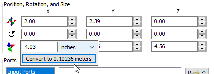

The JT importer has a known issue that it does not currently scale the object correctly based on the units specified in the file. The file will come into FlexSim in whatever units your model is in regardless of the units specified within the file.
This issue should be fixed in an upcoming release of the library we are using to load the JT files.
In the meantime, you can re-scale your JT shapes using the unit conversion popup on the General tab of an object's Properties window:
1. Click in each size field and then press the Model Unit Conversion button:
2. Select the model units that the shape was built in and then press the Convert button:
