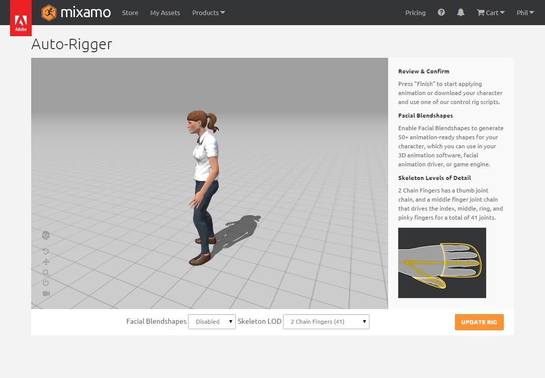

Character Rigging
From Mixamo Fuse, you can press the Animate button in the upper-right corner to upload the character to Mixamo’s website to apply animations. You will need to log in with a Mixamo account.
You will be presented with the Mixamo Auto-Rigger. After a few moments, your character will appear in a view with a default animation applied.
Choose whether to enable facial blendshapes and select the appropriate level of detail for the skeleton, such as 2 Chain Fingers, and then press Update Rig. The auto-rigger will reapply and the view will be updated with the newly rigged character.
If the settings are good for your needs, press the Finish button.
