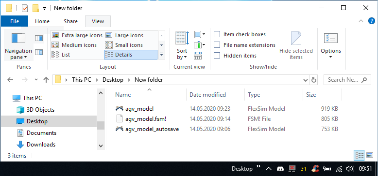

Thanks for your feedback @phil.bobo. I did not take a larger screenshot, so I can't confirm if the "Date" or "Date modified" was shown.
So I have done a new example. It's 9:51.
The "Date modified" for the 3 files are:
  • model: 9:23 (28 minutes ago)
  • .fsm!: 9:14 (37 minutes ago)
  • autosave: 9:06 (45 minutes ago)
Here is what is show in the right-click properties window for these 3 files:
So, imagine the user is working on his model and FlexSim crashes at 9:51. He will then look in his folder for the most recent file. He will be suprised to notice that the last autosave was 45 minutes ago ! And in this case finally the most recent file is the manual save at 9:23. So this user lost 28 minutes of his work and the autosave was not helpful at all.
Here is the sequence of events that can lead to this point:
  • 8:56: I open the model. The next autosave is scheduled at 9:06.
  • 9:06: autosave. The next autosave is scheduled at 9:16.
  • 9:14: I save the model. So the next autosave is actually postponed at 9:24.
  • 9:23: I save the model: So the next autosave is acutally postponed at 9:33.
  • 9:33: the model is running. So the next autosave is acutally postponed at 9:43.
  • 9:43: the model is stopped, but not in a reset state. So the next autosave is acutally postponed at 9:53.
In the end, there are so many situations which postpone the autosave that you can end up with an autosave file much older than 10 minutes.
If the checkbox says "autosave a model backup every 10 minutes", the user would expect it to "autosave a model backup every 10 minutes". If it does not autosave a model backup every 10 minutes, then the name of this parameter should be changed.
Or, as suggested in my 1st post, the autosave feature could also be improved.
For example, if the model is not in a reset state when an autosave is scheduled, instead of postponing the next autosave in 10 minutes, the next autosave could be triggered at the next model reset.
