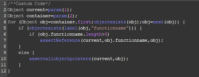

3. assertallobjectpointers(<involved>, <container>)
Purpose
This is the recursive traversal function.
It walks downward through the tree under container and looks for objects with a non-empty functionname.
When it finds one, it adds a reference on current using that object’s function name.
When it encounters an object with no functionname, it does not stop. Instead, it recurses further downward through that object’s children.
This is the key to skipping non-functional levels in the tree.
In effect, this command says:
Starting from the current functional object, keep searching downward until you find the next lower functional objects, then create references to them.
That is what allows the reference chain to reflect logical structure rather than every structural level.
