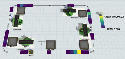

The attached model draws a heatmap based on the total time AGVs are blocked in a particular location.
Approach Outline
This model creates the output graphics as follows:
  • There is a Group of all AGVs.
  • A Statistics Collector listens to all state changes on all AGVs in the group.
    • Each time an AGV goes into the “Blocked” state, the Statistics Collector adds a row, recording the location of the AGV and the current time.
    • Each time an AGV leaves the “Blocked” state, the Statistics Collector updates the row for that AGV to calculate the total time the AGV was blocked.
  • A Shape object (called CongestionHeatmap) reads the data in the Statistics Collector and draws the heatmap.
    • All block times in the table are grouped into spatial “Pixels” based on the block location.
      • Note: this article uses the word Pixel to mean the squares in the heatmap.
    • For each Pixel, the shape sums the total block time in that Pixel.
    • Pixels are colored relative to the Pixels with the most and least block time.

  • The legend, drawn near the CongestionMap shape object, shows the numerical values for the min and max block time.

  • The heatmap is drawn using a mesh. The mesh is more complicated to create, but is much, much faster to draw than using other draw commands.
    • Meshes are used to draw triangles. Each Pixel is drawn as two triangles that form a square. All vertices of that square are set to the same color.
    • Using a mesh also made drawing the legend simple. Meshes always interpolate colors between vertices. The legend draws squares where the top vertices are set to one color and the bottom vertices are set to another.
  • Moving the CongestionMap object does not move the Pixels, so you can place it anywhere in the model. The legend won’t move until the next model run.
