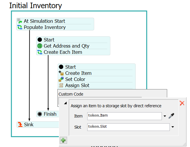

The model includes a Global Table of Initial Inventory. The process flow's initial inventory section reads this table, and then creates items and places them into slots based on that initial inventory. This logic relies on the Address Scheme defined in the Storage System object, and uses direct addressing to get a slot using Storage.system.getSlot().

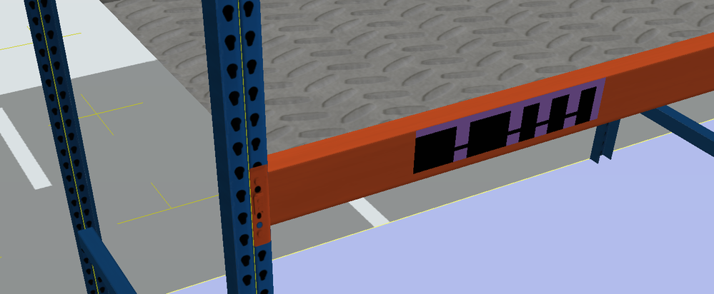

For me the rack addresses are not drawn correctly, but as black boxes, when I open the demo model. See the attached image. Is this a graphics issue or something else?
Thank you!

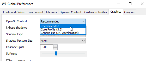

Change your OpenGL Context from "Core Profile (3.3)" to "Recommended":
In 19.2, the Rack's text rendering is using a deprecated OpenGL texture format, so it doesn't render correctly with a Core Profile.
While making improvements to the text rendering for 20.0, we've fixed this bug. For now, just use a Recommended context instead of a Core Profile.

It works! Thank you.

I am going through the model, I have one doubt in Initial Inventory as explained below
In below images, Assign Slot (token.item directly we are assigning a token.slot ) and Get Destination (Label Name Destination and we are giving Value token.Slot.as(Storage.Slot).storageObject)
Looks bit confusing because in Assign Slot we are assigning /Rack1>variables/bays/1/levels/1/slots/1
and in Destination we are assigning /Rack1.
In Move Item Into Destination we are moving to /Rack1.( as shown in below Image for id.267). When we are moving to /Rack1, how is it moving to /Rack1>variables/bays/1/levels/1/slots/1
The item doesn't actually move into the slot node. The slot just tells the rack what position within the rack the item should be at. In the tree, the item is a subnode of the rack, not of the slot node.
@jordan.johnson In Move Item Into Destination the token.Destination is /Rack1. When we are saying Destination is /Rack1 but the items are moving to /Rack1>variables/bays/1/levels/1/slots/1. How this logic is working in that way.
The item's aren't moving to Rack1>variables/bays/1/levels/1/slots/1. The items have been assigned to that slot. That slot knows how many items have been assigned to it, and its size. When items move into a rack, the rack looks at the assigned slot, and uses that to place the item in 3D space. The item is inside the Rack, placed at the location determined by the slot.

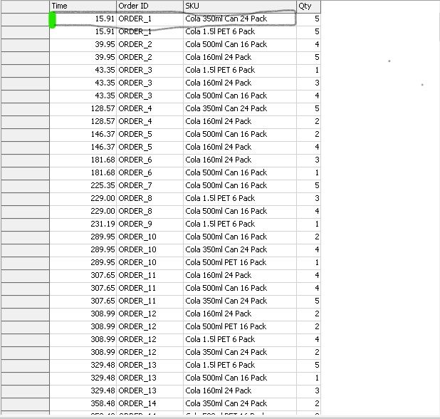

How can I have the operator pick me up several orders at the same time depending on the order history?
I want to know if the operator can retrieve the first order at the same time, is to say that the order of 5 boxes of Cola 350ml Can 24 Pack collect them at the same time.
