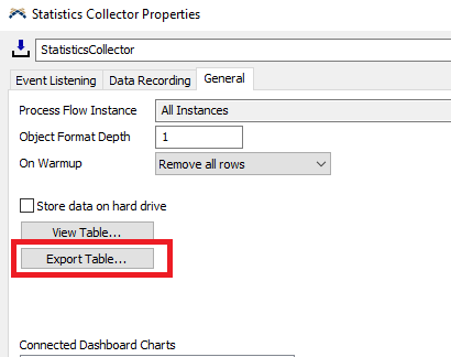

I used an Item Trace Gantt chart, which shows where the flow items are at different times in the simulation and looks like the image below.
This chart creates a standard Statistics Collector with time values we can use to calculate the waiting time and processing time. The only thing that's missing is we don't know which objects represent either "waiting" or "processing." To include this, I simply put a binary label called "timeType" on each of the queues and processors that indicated whether the object was a 0 - "waiting" or 1 - "processing" type object.
Opening up the statistics collector through the tree as shown below, we can add a data tracker on this "object type" label that listens to the event object and checks the label to see if the item just finished waiting or processing.
From the Stats Collector Properties window, we can go to the General tab and click Export Table after a model run to collect all the data in a CSV file.
I couldn't find a good way to aggregate and show this data in FlexSim (I couldn't find a function to calculate the difference in dates), so I took the raw data (shown below) and ran a sql query to aggregate the data to what we need.

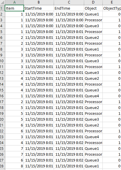

The SQL Query I used was the following:
SELECT item, SUM(DATEDIFF(starttime,endtime,"second")) AS timeDiff, objecttype
FROM time_type_test
GROUP BY item, objecttype
ORDER BY item
The results came out to look like this:
As you can see, we now have data that we can work with to see how much time each item spent waiting vs processing. To explain each column:
1) The "item" column is just the number of the item that entered the system in chronological order.
2) The "timeDiff" column is the SUM of the calculated DIFFERENCES between start and finish times GROUPED BY the type of time, whether "waiting time" (=0) or "processing time" (=1).
3) The "objecttype" column tells us whether the object that the flow item entered/exited was a "waiting" type or a "processing" type object.
I know this is a bit of external work to get this data, so hopefully we can find a way to get this within FlexSim, but for now, maybe this will help. Let me know what feedback you have...
