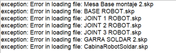

The problem is when I add the plane to a new user library
*The plane contains the robot, the cube (that is really a processor), the queue and the mesh
If I add the plane to a new user library and I drag the plane form the user library to my model (wich already have the original robot station), when I run the model I get the following message: 1646700486250.png
Add if I just copy and then paste the plane in my model it works and I don't get the error message:
But I supposed that copy and paste is the same than adding the plane from an user library, what is wrong?

Also, do you know how to save my drawings within my user library? Otherwise when I drag mi plane from my user library into a new model FlexSim does not find the files:
I saw this answer but still I can't do it:https://answers.flexsim.com/questions/34638/possiblity-of-saving-packedmedia-node-into-a-user.html

Hi @Jason Lightfoot, when I import the library that you uploaded here it works perfectly, but when I tried to import the library I builded by myself I get the same error message.
This is my user library and I also changed the name CabinaRobotSoldar.skp so it does not have spaces.
Do you know what am I doing it wrong?

7.- Then I tried to import tis library into a new model and I get the error message:
Thanks a lot for your help!

When you say "import into a new model" are you saying when you try to load the library it gives you the error, or when you try to drag/drop a new instance into the model? I ask because I don't get those error messages you seem to have at any stage with the library you uploaded.
Message 9 of 10
CarlosReyes
When I try to load the library I uploaded Fanuc.fsl.
But I can open the library that you uploadad, that is odd.
Message 10 of 10
CarlosReyes
Update: I move my library to another folder and now I load my library into a new model and it works.
I don't know what could be the problem but it works now.
The error in process flow still happen the first time but if I do what you told me twice (drag the object to the model and clic reset button) the error disappears
