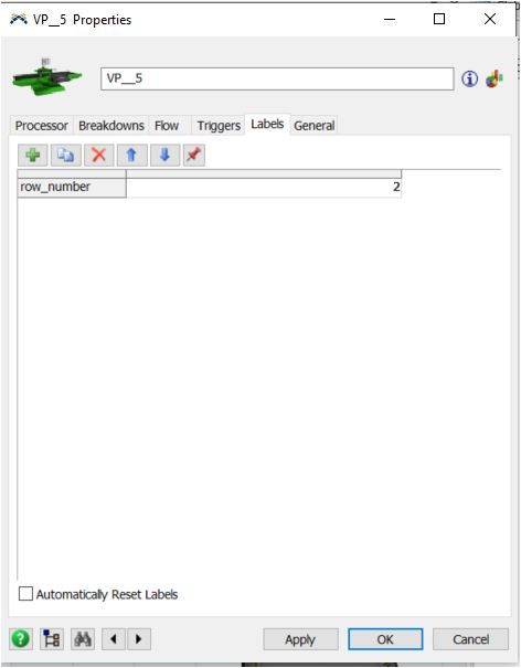

1623922269946.pngand I set the number label (row_number) to each processor with value 1 for pp-uri
ex1.jpg...........................................................
ex13.jpg and value 2 for vp-uri, tp_1, cp_1.
ex14.jpg...........................................

To avoid adding labels to all queues, you can set the "machine" label to the processor itself, so the row_number can be read from there and then use
token.machine.inObjects[1]
as destination in the unload acitivity.

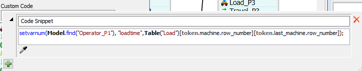

I realized when analyzing the simulation results that I omitted the fact that if the operator moves from vp / tp_1 / cp_1 to pp the duration must be different. At this point in the simulation model only the idea of moving to pp and vp / tp_1 / cp_1 is considered. How could I do this in this model?
Message 17 of 23
moehlmann_fe
I'm not sure I understand what exactly the goal is but I can show you a general solution to make the loading/unloading times dependant on the machine(-group) the item comes from.
For this I added a second column to the Load and Unload table. The first column are going to be the times used when the item is taken from a machine with row_number one, column two when taken from one with row_number two.
In the Process Flow I add a new label in the "Machine_Px" activities called "last_machine", which references the machine the item visited before the current one. For that I use the same code that is used in the "Write Move Time to Table" activity ("P1_Process" has to be adjusted to P2 and P3 of course):
Table("P1_process")[Math.max(token.operator_number-1, 1)][2]
Instead of getting the current machine, it looks up the last machine (token.operator_number - 1). The "Math.max()" command is to make sure the row_number doesn't become 0 on the first run through. This means the loading/unloading times from the initial queues P1-P3 will take the same time as if the item came from a machine in group one.
Then, in the "Load_Code_Px" and "Unload_Code_Px", the column number "1" gets replaced by "token.last_machine.row_number". The column the time is taken from thus depends on the row_number label of the machine the item is loaded from.
This solution is scaleable, so if you need more granularity you can subdivide the machine groups by introducing more values for "row_number", adding a new row and column to the Load/Unload tables for each additional value (Have to be consecutive 1,2,3,...).
This way, in theory, you could define separate times for each pair of machines if you give all machines a unique "row_number" value.
licenta-fin_FM_v20190.fsm
I hope this helps with what you are looking to do.

It is not 100% correct what is being simulated now. So the loading/ unloading time from any pp to any vp or from any pp to tp_1 or from any pp to cp_1 must be 3600 seconds (1 hour), the loading/ unloading time from any pp to any pp must be 1800 seconds (0.5 hours), the loading/ unloading time from any vp to any pp or from any vp to tp_1 or from any vp to cp_1 must be 3600 seconds ( 1 hour), the loading/ unloading time from tp_1 to any pp or from tp_1 to any vp must be 3600 seconds (1 hour). This time must be seen as a matrix. The table below describes perhaps more clearly how the problem should be solved.
I apologize for the inconvenience and    for not being careful. This is the last     problem to be solved in my simulation model. Please, help me to finish this.
Message 19 of 23
moehlmann_fe
You can do this with the model I attached in my last comment. Swap the rows and columns in your table (or don't as it is symmetrical) and paste it into the model as the "Load" and "Unload" table. Then adjust the "row_number" labels on the processors accordingly (PP -> 1, TP -> 2, VP -> 3, CP -> 4)
I apparantly forgot to do what I wrote in my comment and didn't adjust the the assignment of the "last_machine" label for the P2 and P3 flows, so they were getting the wrong machine information. I apologize for that.
This version should now work according to your matrix:
2*1800 for transports inside the same group, 2*3600 for transports between different groups.
licenta-fin_FM2_v20190.fsm
