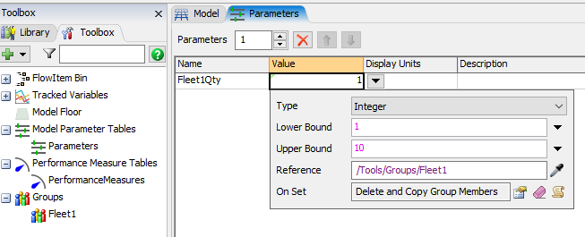

2. When you put the forklifts into groups you can use the "Delete and Copy Group Members" option in the parameter table (use the sampling tool on the group to see the option)

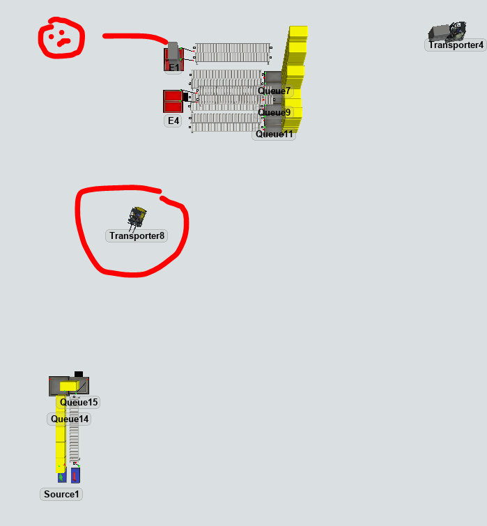

After simulating fleet 2 AGVs, the simulation runs without error now. Few things that I am struggling to do -
1. Fleet 1 and Fleet 2-
According to the list and orders, the Forklifts picks the full and empty pallet in sequence generated in the list. I want to modify the process further. No matter what sequence is generated in list, the forklift should never return empty to home position if there are empty pallets - See pic attached,
2. I want to run an experimenter and optimizer to check the number of forklifts needed in fleet 1 and fleet 2 separately to do 110 boxes supply and 110 empty boxes return.
Can you please help?

1. E1 pushes the items onto the "Empty" partition on the list. The Pull from List activity is set up to pull from the list in general (no partition set). So the items in E1 are not "seen" when trying to pull something.
You can only ever pull from a single partition, where you can think of "No Partition Set" as being its own partition.
2. As I said above you can easily alter the quantity of forklifts through the mentioned parameter option.
You then just need a performance measure. This could be the input to Queue15, for example. Then you vary the number of forklifts until you find the threshold where the input reaches 110 in the allotted time.
