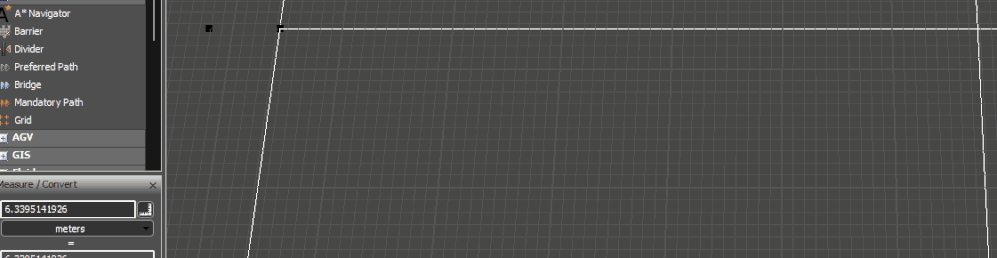

If you want to know how big your Rack should be, you can use the measuring tool (found in View > Measure / Convert). It will appear in the bottom left corner of FlexSim. Here's an example of how to use it.
You can take that measurement and apply it to the bays in your Rack. That way, when you go to line up your racks with your background, their bays are the same width as the model. The same applies to any Floor Storage you have.
