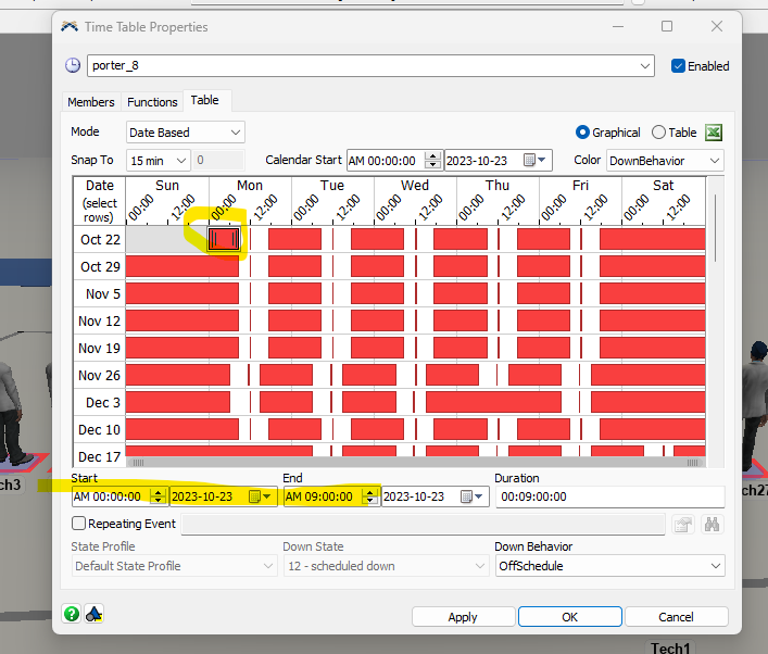

At 6:00, for example, all the staff are in State: OffSchedule.
The red square indicate they are stopped and the state is OffSchedule:
And if I look at Staff8, for example, he is not scheduled to work until 9:
So the problem seems to be your schedules. The red is when they don't work.

From what I could see, at 6:00, they were all Offshedule.
Give me an example of a staff (which one) doesn't work when he should according to his schedule and tell me at what time. If he has a red square around him, it's because his timetable says he is off.
