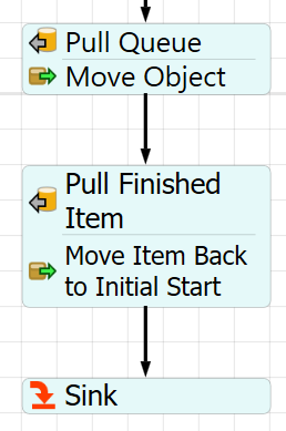

kavika_faleumu
Hey @jpanY7K8B
Regarding the pileup, that's due to your Process Flow pulling the two initial Queues but not Pushing them back onto the list. If you want to make sure that they're always available to be pulled, you can check the "Leave Entries on List" box. That way, even when they get pulled due to a query, they'll stay on the list for other tokens to pull. Then you don't need to worry about pushing them back on.
With regards to your Process, I think I see where the issue is. You're moving boxes to the correct Queue, but then your Wait for Event is waiting for those boxes to exit the Queue after they've already left to be processed. So that token never gets processed.
You don't want to wait for boxes to leave the Queue -- you want them to finish processing first. From there, there are several ways you could move items to their next PreProcessing Queue. You could push them to an ItemList then have the Initial Start pull from that List. You could move the items straight to the next Queue using Process Flow or Input/Output/A-Connections in the 3D view.
Attached is an example model modified to use one of these ways.
Firstly, you've got conflicting logic in 3D and Process Flow. I'll move the incrementing of the "Step" label to Process Flow. That way, when items enter and a new token is created, we can be sure to increment once.
After we've setup the token and we determine that it still has steps to do, we can pull a Queue (while leaving it on the list). Then, we'll let the 3D objects handle it until the last Processor finishes.
It will push it to an ItemList. In Process Flow, we'll wait to pull an item from the ItemList so we can move it back to the Initial Start.
Hope this helps!
Message 16 of 18
jpanY7K8B
@kavika_faleumu
Thank you for updating the model with detail explanation. When I test run the model, I encountered issue:
  • After successfully processed 21 boxes, processor 1, 2, 3 stopped with processed boxes. and rest of the WIP start pilling up. Also, System console has the follow error message. I guess this error is related to MTBF. Once I disable MTBF, no issue to run the model. But I have to idea how to setup MTBF correctly.
time: 3961.030532 exception: Exception Caught in Processor::onTimerEvent(treenode involved, int code, char *datastr) object: /Processor4
time: 3961.030532 exception: Exception Caught in ObjectFunction246__project_library_FlexSimObject_behaviour_eventfunctions_OnTimerEvent object: /Processor4 class: /Processor4
time: 3961.030532 exception: Exception caught in TreeNode::receivemessage()
time: 3961.030532 exception: Exception caught in Executive::processeventinlist().
  • Can you please also explain why the model redirect token back to "Delay". In the attached file, I removed MTBF. As you can see I added to other methods to compare with "original Product Creation". Method 2 works. but not method 3. Did I miss something? Please correct me. Thank you very much.
Message 17 of 18
kavika_faleumu
Hey @jpanY7K8B,
To fix the first issue, I believe it was a problem with the "Pull Finished Item" activity. The "Assign To" property was `token.pulled`. I changed it to `token.Item` since the subsequent "Move Item Back to Initial Start" uses `token.Item`. (Of course you could do the opposite as well, changing the variable in the Move activity to be `token.pulled`.
For your second question, the reason we loop back to a Delay is to avoid creating more tokens and to simplify creation. The original item creation method simply created 2 tokens and would use those to create items every `token.Interval`. Of course, it's fine to also used Inter-Arrival Sources to spawn new tokens every X seconds and then send them to a sink. For the 2nd method, you would need an Inter-Arrival Source for every different time interval you want to spawn a token at.
Message 18 of 18
