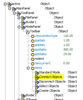

If you really want to add those buttons to your user toolbar you can copy those nodes in the tree, by copying this node:
33601-1603398540479.pngInto the environment/usertoolbar node:
Or, alternatively you could open a script window and run this line of code:
createcopy(node("VIEW:/active/MainPanel/ToolPanel/ModePanel/Toolbar>items/Connect Objects"), node("VIEW:/environment/usertoolbar"))
