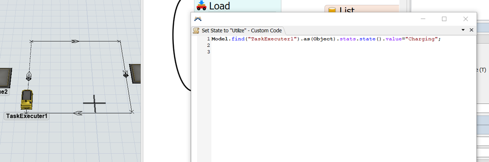

I am trying to set the AGV in the custom state "Charging" which is not available in the list. I am using custom code directly as below:
But my code is not making any impact.
What is the quickest way to do it?

Hi @Felix Möhlmann,
I just checked it is setting the state, but it is not shown in bar chart as other preexisting states are shown.
Whether I am missing anything?

Hi @Jason Lightfoot,
It is showing "Accumulating" state in chart instead of charging.
Please have a look here.
