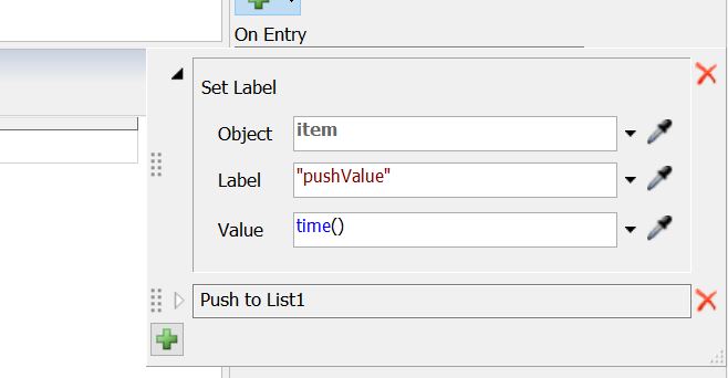

hello @Enrique Elizaga ,
I think the fastest way to do it is to set up a label in the Item when you push it to the list so you can retrieve in the processFlow
Something like this example:
pushTime Example.fsm
enrique.elizaga
@Julio R Is there a way to add that label directly as a push argument or expression? Items are pushed from many objects.
julio_r
You can modify the code in the List label to add it to the item, that way it will always do it no matter where it has been pushed from:

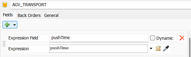

jason_lightfoot_adsk
You can add the list fields you want as labels to the SELECT of the pull query - then they get added to the puller automatically. Eg.:
SELECT age, pushTime WHERE age>30 ORDER BY age DESC
When that doesn't work check the list advanced setting to do this is still checked.
