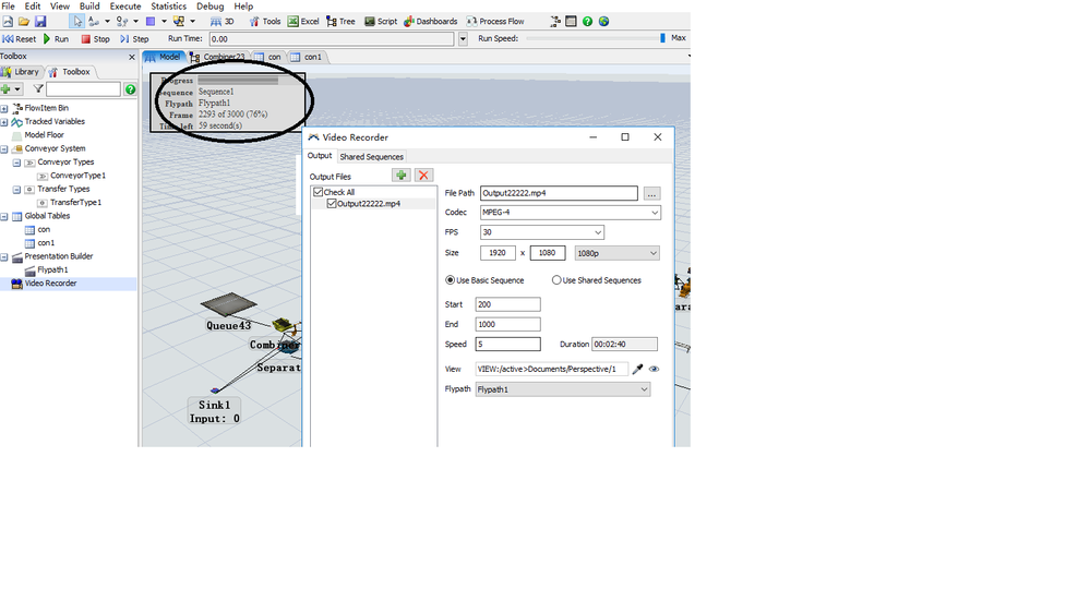

when i record a video,i want to stop recording during the record processing,when i click the reset button video record stop,but the processing bar remain on the screem,,like pic below.
When i restart record ,the process bar wont change anymore.
why this happen?Could someone give me some suggestion?thank you very much.Image.png

The pic you uploaded is broken.
I think you can stop the model first and reset the model.
In addition, you need to delete the recording log files in the model directory if existed before reopening the model.

ok i will upload my pic,do you mean the record log files in the toolbox libirary?thank you very much27955-27708-无标题.png
bo_wang
No,the record log file was existed model file saving directory.
