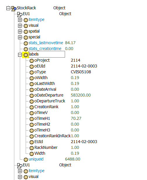

I have a queue with multiple items. Each item has its labels, and I would want to know the number of items that the label "oDepartureTruck" == X. How can I do that?
Thanks!

Can you give a hint on how to do it using the query?
Table.query("SELECT count(*) FROM $1 WHERE $2", Model.find("StockRack"), item.labels["oDateDeparture"].value == 1.00)[1][1]
The "where" clause, I do not know how to do it...
